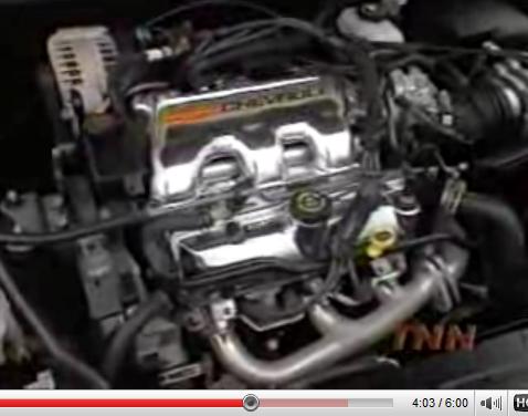

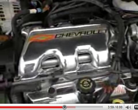

    if only we knew how exactly they did this... theres some filler stuff, but the malibu is the important part...
    Headers for certain, not sure what else was done.

          Anyway, that TB on the 3400 in the malibu almost looks like a 96+ DOHC TB or something (similar to the Intrigue style)
          Those headers aren't really even headers... no collector on the front...
          A cam, high compression sounds about right for that power level like the comments on the video says.

                          Those headers were kind of funny looking. Long-tube maybe? Large-port topend as most (if not all) 3100's in 98 were still using the small-port parts.

                            Those really weren't headers from what the front manifold looked like. Looks like the 3800 style manifolds. Headers would have all the primaries going into a collector so you would get the scavenging affects. Those were just tubular manifolds.
                            The malibu had a 3400 in it, if you read the comments on the videos it says upon further research it was a 3400... And yeah you can tell it was at least a large port manifold.
                              "Did some googling. My bad, its a 3400.
                              From Popular Mechanics: ...A 238-hp, 3400 pushrod V6 borrowed from the Chevy Venture minivan. It's been enhanced with high-compression pistons, a high-lift camshaft, stiffer valve springs and better breathing.""

                              1. shot of the intake: definitely a large port, and with no script on top, PROBABLY came from a van.
                              2. full motor including the exhaust manifold: what a funky design...
