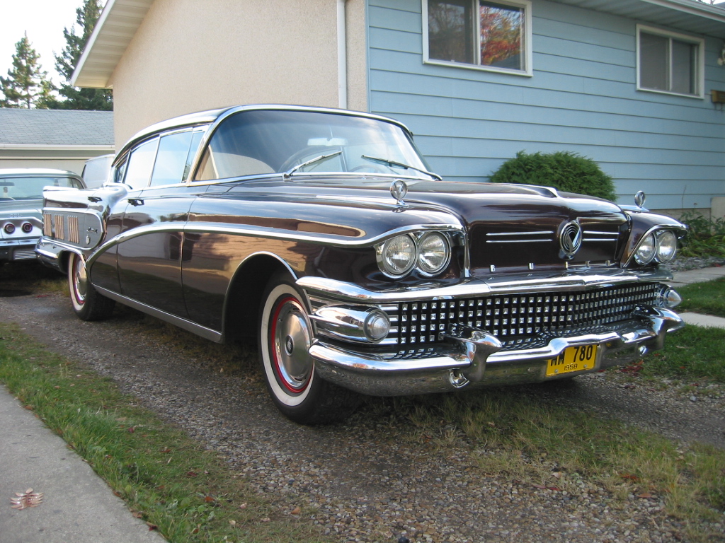

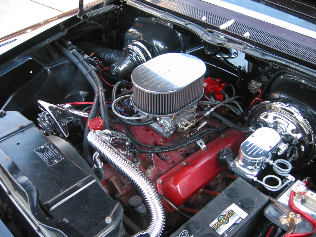

            We specialize in restoring/building classic cars and have many, many years of experience.
            This is one example of a 58' Buick limited that we have been 4 years on.
            We still have TONS of work to do on it, the engine if far from done.
