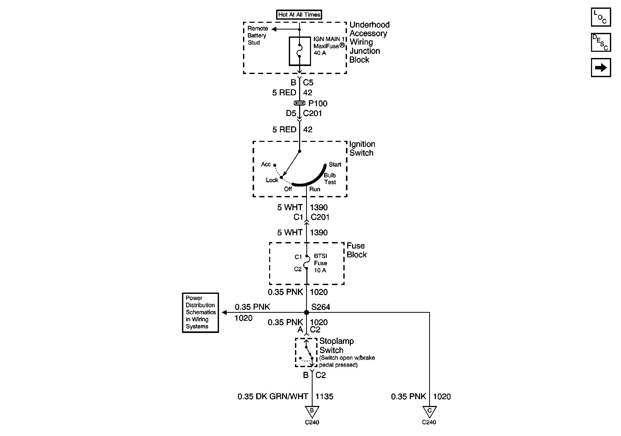

What does this symbol mean?
I need to bypass the KEY SOLENOID, but it looks like it is a RESISTED GROUND. Can anyone help me with this? This is the first time I have ever came across this symbol, and it has me STUMPED.
Thanks
