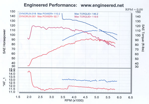

                      Here is another one from a guy who was experimenting with tuning and re-programming the stock 2.8. The red line is his original reading with the blue line showing his result after careful tuning with modified chip.
                      Some guys have reported 115 hp but most not that high, and generally not 100% stock. One of our local guys with a 2.8 auto reported 93 whp.
                      Hope this clarifies the info.
