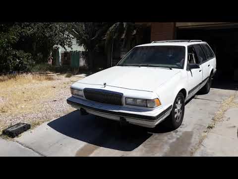

                            May 27, 2019:
                            I had to swap the intake manifold AGAIN because I blew out one of the EGR bolt holes AGAIN. It was sucking air in and the engine refused to start at first, then idled at 2500, then idled between 600 and 1000 like total dog shit. I put blue thread locker on this time. (future me says it worked)
                            Once that was sorted...
                            As I said in the video, the downpipe was not bolted to the rear manifold. I've done that a couple times now, and it sucks majorly on your back with a swivel, threading the needle between the steering rack and the firewall. So I took it to my nearest reputable mechanic shop and paid them to do it, along with an alignment. They also repaired the alternator charge wire, which was a giant piece of shit for a long time.
                            The first daylight George has seen in six months. I also slapped those LeSabre/Reatta wheels on. Uniroyal Tiger Paws in 215-60/15. No center caps for now, since they're surprisingly difficult to find.
                            And since I had the transmission regeared, out came the trusty old laptop to change the tune. Just need to set the final drive multiplier to 1 in HP Tuners.
                            Watch this space for burnouts and a new time slip.
