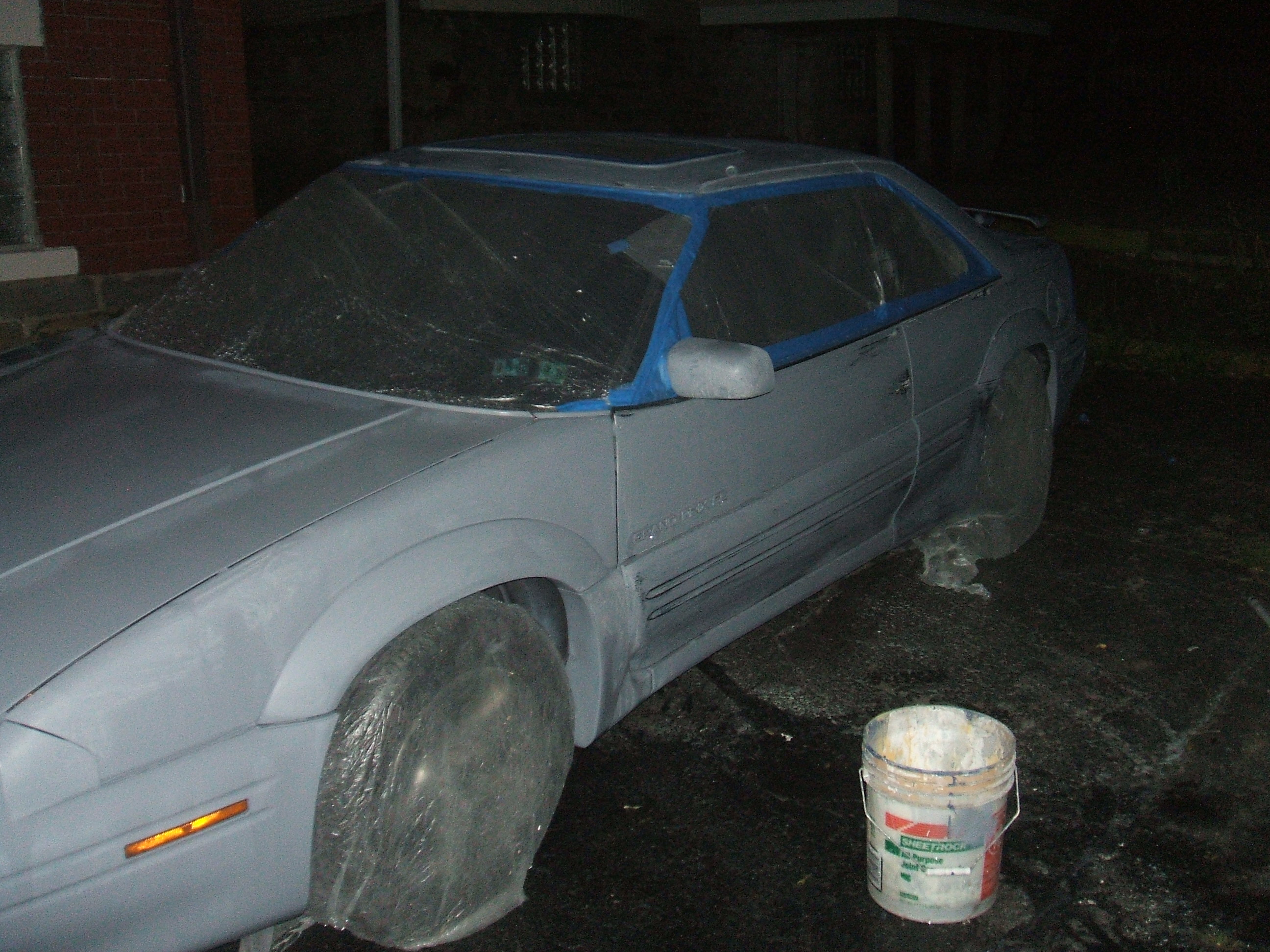

    After 1rd coat of Primer Sealer and wet sand
ID:	381300Click image for larger version
ID:	381301Click image for larger version

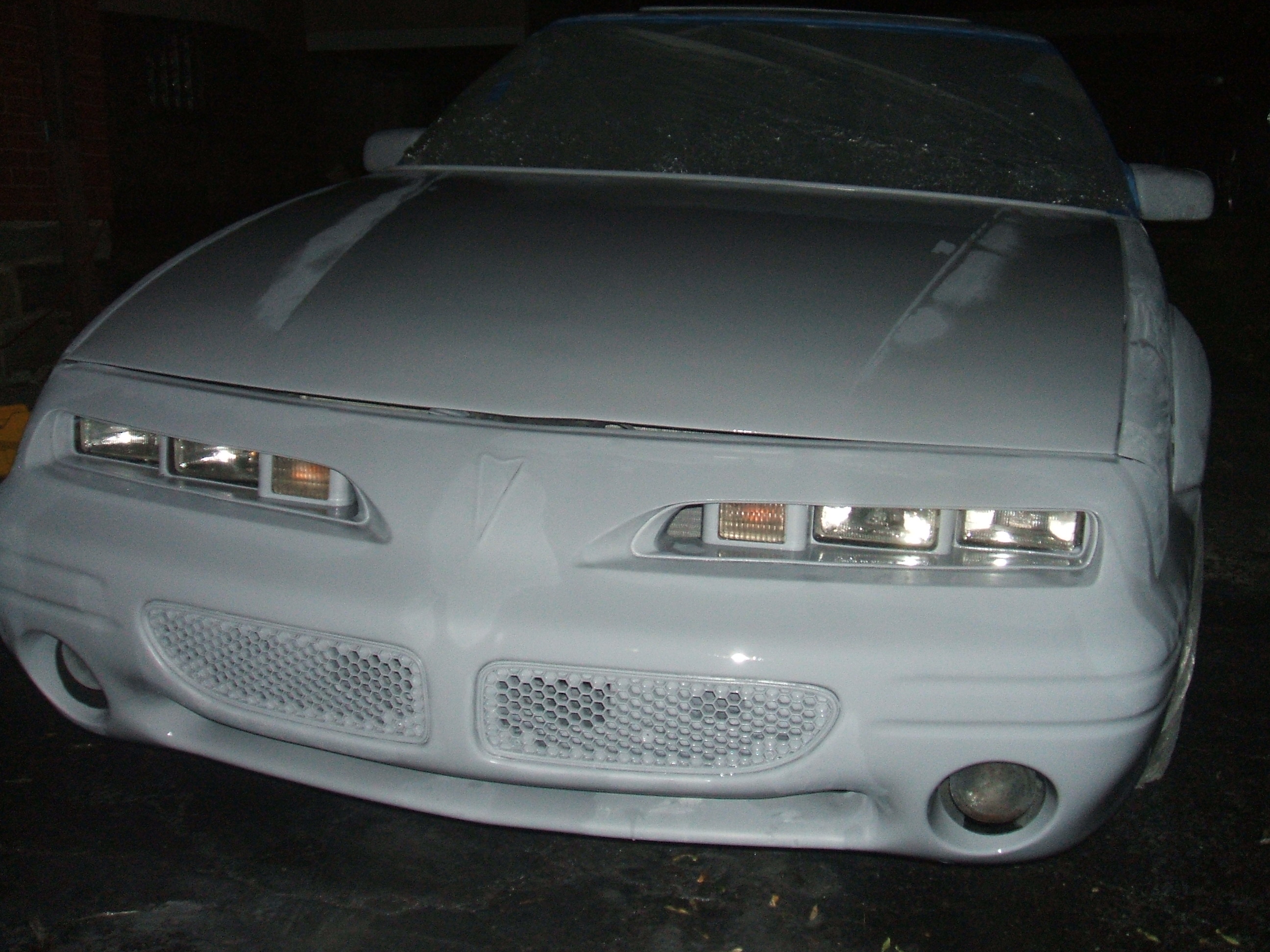

    After 2nd coat of Primer Sealer
ID:	381297Click image for larger version
ID:	381298Click image for larger version

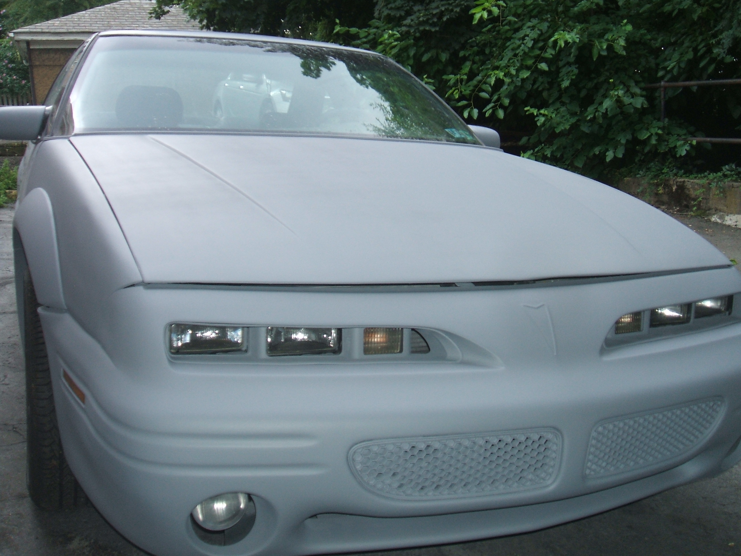

    I decided to remove the masking to make sure no paint was getting past the blue tape. All was good. I also like to remove tape if there are several coats on them. Too much build up can peel paint, though I can;t say for sure with Acrylic Enamel, I've seen it on other paints.
    I got a 3rd coat of sealer and it looks sharp. I'll get the pics up after I take them. Once I was done spraying I went inside, showered the grim and heat off.....sticky nasty heat this week. Can't spray in sunlight, too hot. Dusk is perfect.
    I don't know when I'll get the final coat of color/clear and wondering if I should pay a shop to spray the final. I know I can do it but I also know those spray guns can spray a larger fan width and essentially lay down a smoother coat. And that they can use the lethal 2 part paint that is hard as anything I ever came across as paint.
    But not until I get surface perfection......until then......she is a grey car, lol.

      I got to wet sand with 1500g yesterday evening. I had the hose on wide spray and propped it up to soak the car and me with it. That's how hot is has been recently. I was wet sanding in the water with the car to keep cool.
      If you remember I had racing stripes. They were a PITA to sand out. But at least the traces of them are gone. The hood was the worst offender. Dings and dents all over. Also have a coat of heat/sound silencing rubber like spray under the hood to replace the mat that was once there. I really didn't want to paint w/o heat protection from the engine.
