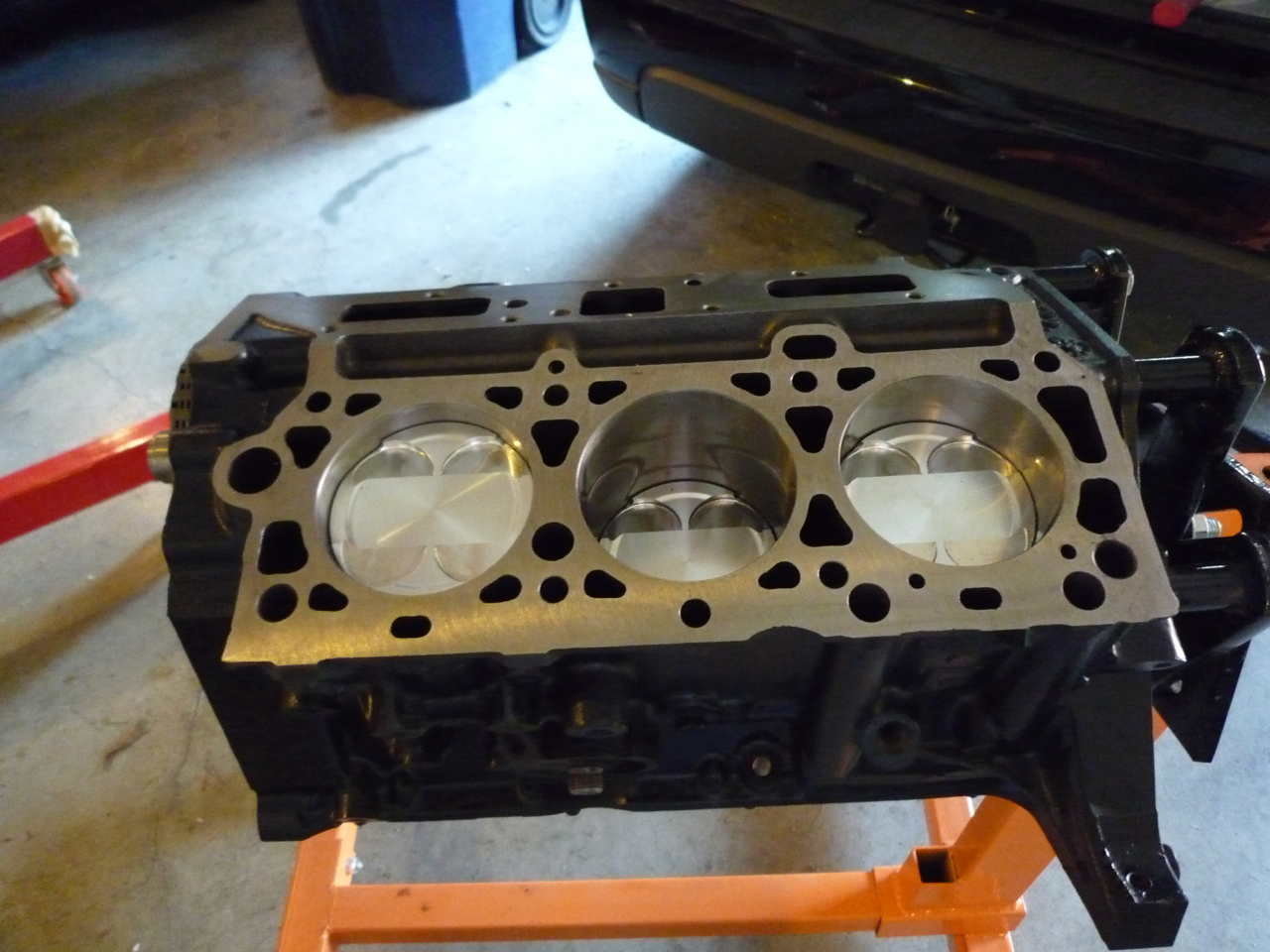

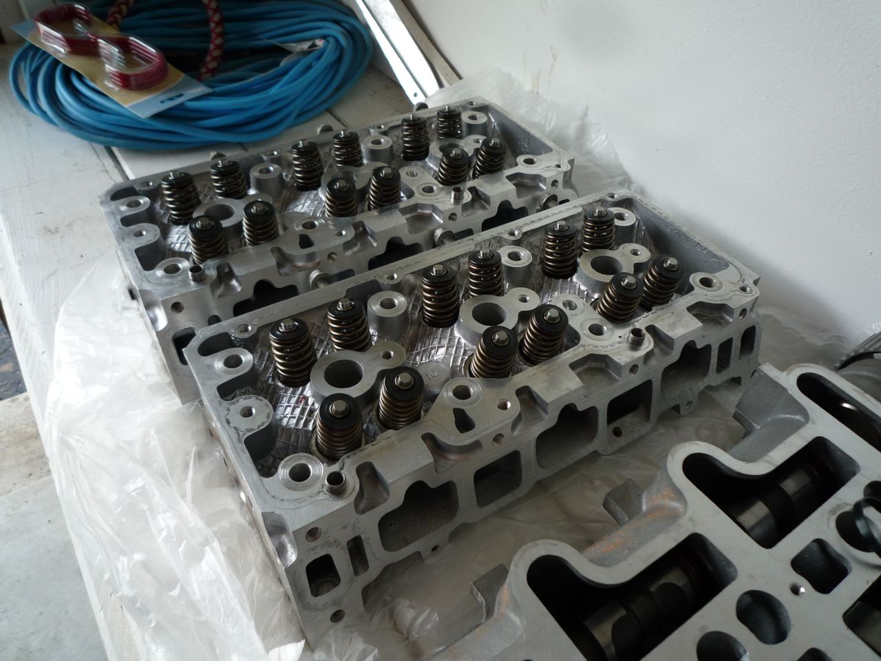

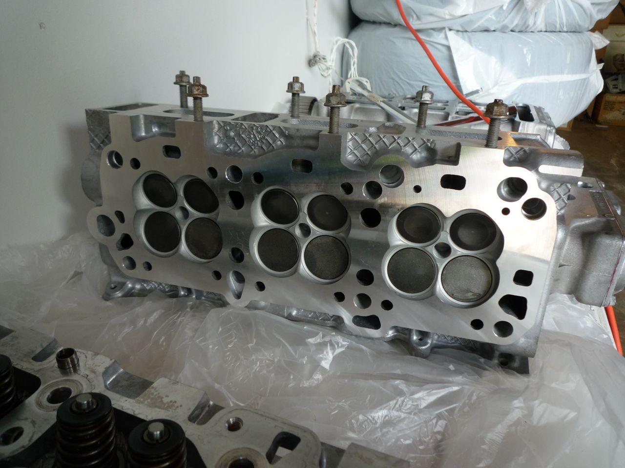

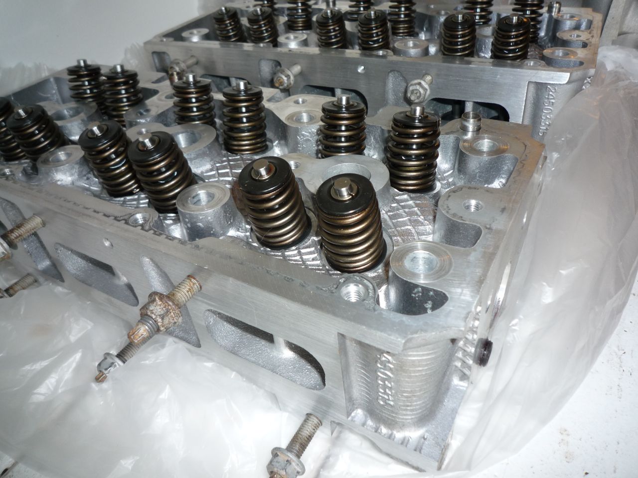

And here are the heads. New valve guides all around that have a retaining disk machined into them, a valve job, everything cleaned up, and the WOT Tech 4.6 SOHC valve springs. It seems the spring pressure is up dramatically over stock. These shouldn't have any issues with valve float.
