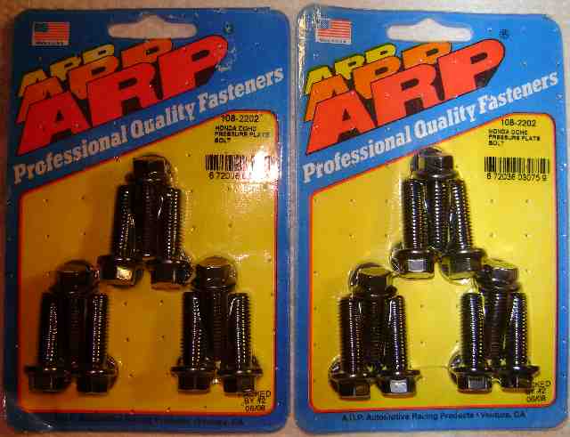

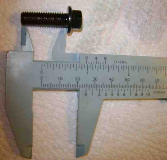

              They run about $30.00 a set, but are well worth the $$$ because once these are slipped between the header flanges and the engine heads and properly torqued down ...your PITA problem of having to re-torque the header bolts on a regular basis will disappear. And as for "header bolts"...I recently stumbled across an exact metric set of ARP bolts (200,000 Lbs Strong) being sold on eBay for the Honda Civic Pressure Plate that are the perfect length of 25mms and metric thread sizing as the stock header bolts and these are almost impossible to gall, break or spin off. But thankfully, with the REMFLEX gaskets being used, you won't be tempted to over tighten and use too much torque to get the headers to seal tight. These bolts include a conical washer design if you prefer to use it. (See the Attached images of these)
