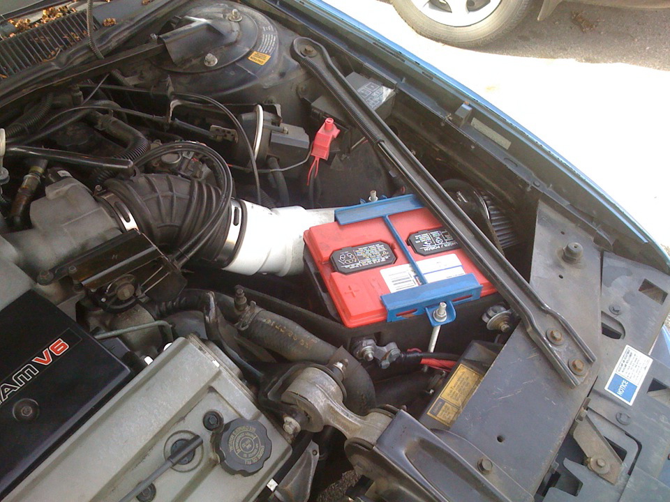

                    I made a FWCAI that would utilize stock battery placement and 3" aluminum tubing. Results were a happy customer and noticeable seat of the pants gain. Under 200.00 When all said & done.
                      A battery relocation is nowhere over $50-75. Also my intakes have a welded bracket so when the engine torques the intake does not get thrown around. I have also had a couple people put the intake around the battery, it just needs to be turned a little.
                        This is mine. I did a Batt relocation. The Wiring was expensive. the intake was cheep except for the Cryo Kit.
                        I dont know what this means but "ASS HATS" is funny
                          If you dont want to relocate the battery you can just move it around a bit. Whole project probably came to $40-$50.
