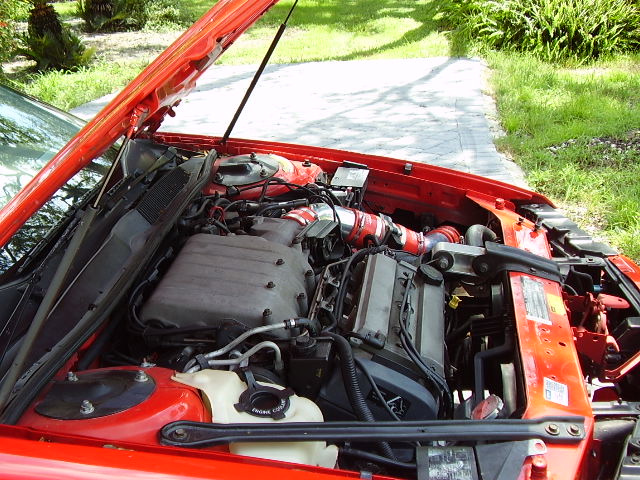

      I make intakes for the 3.4 DOHC

          That's the impression that I got, but hey, correct me if I am wrong guys. P.S. d.o.h.c. do you have any more pics, like where the filter is mounted on your intakes and possible a price?

            I get 150 for those. I can e-mail you more pics, pm me your e-mail addy
