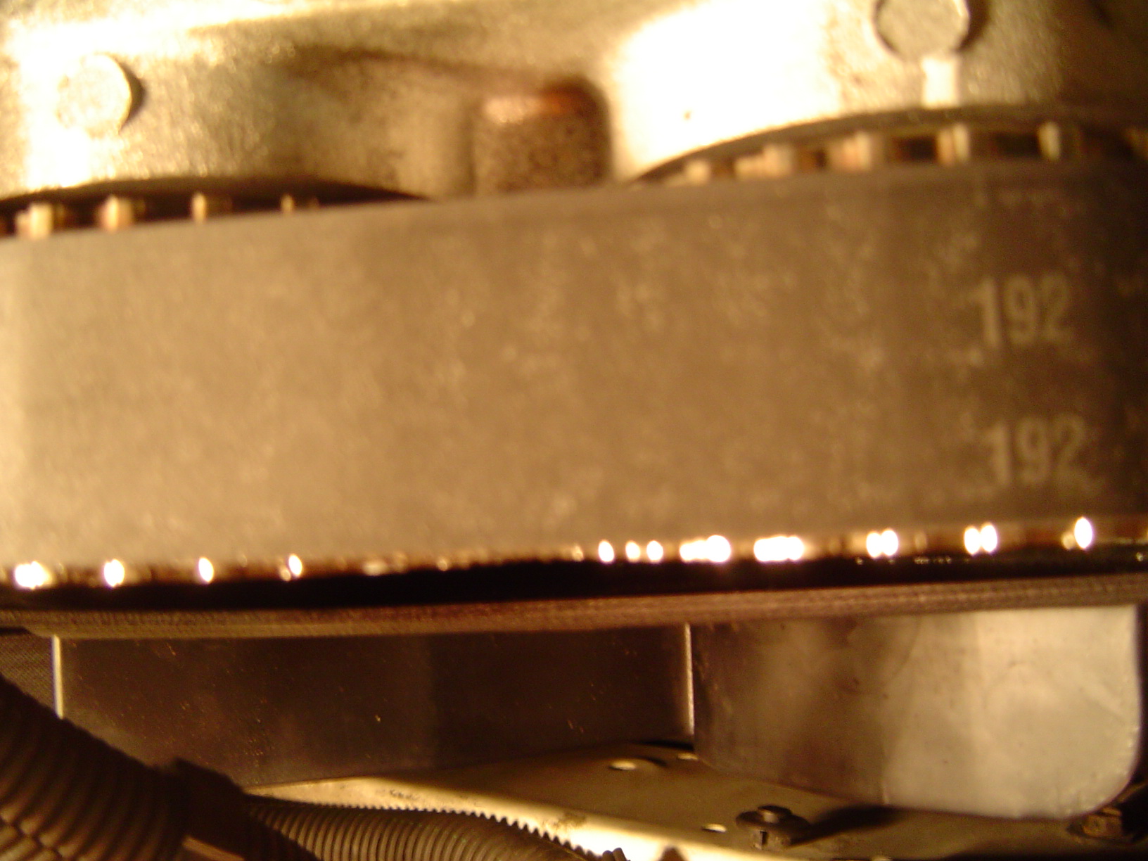

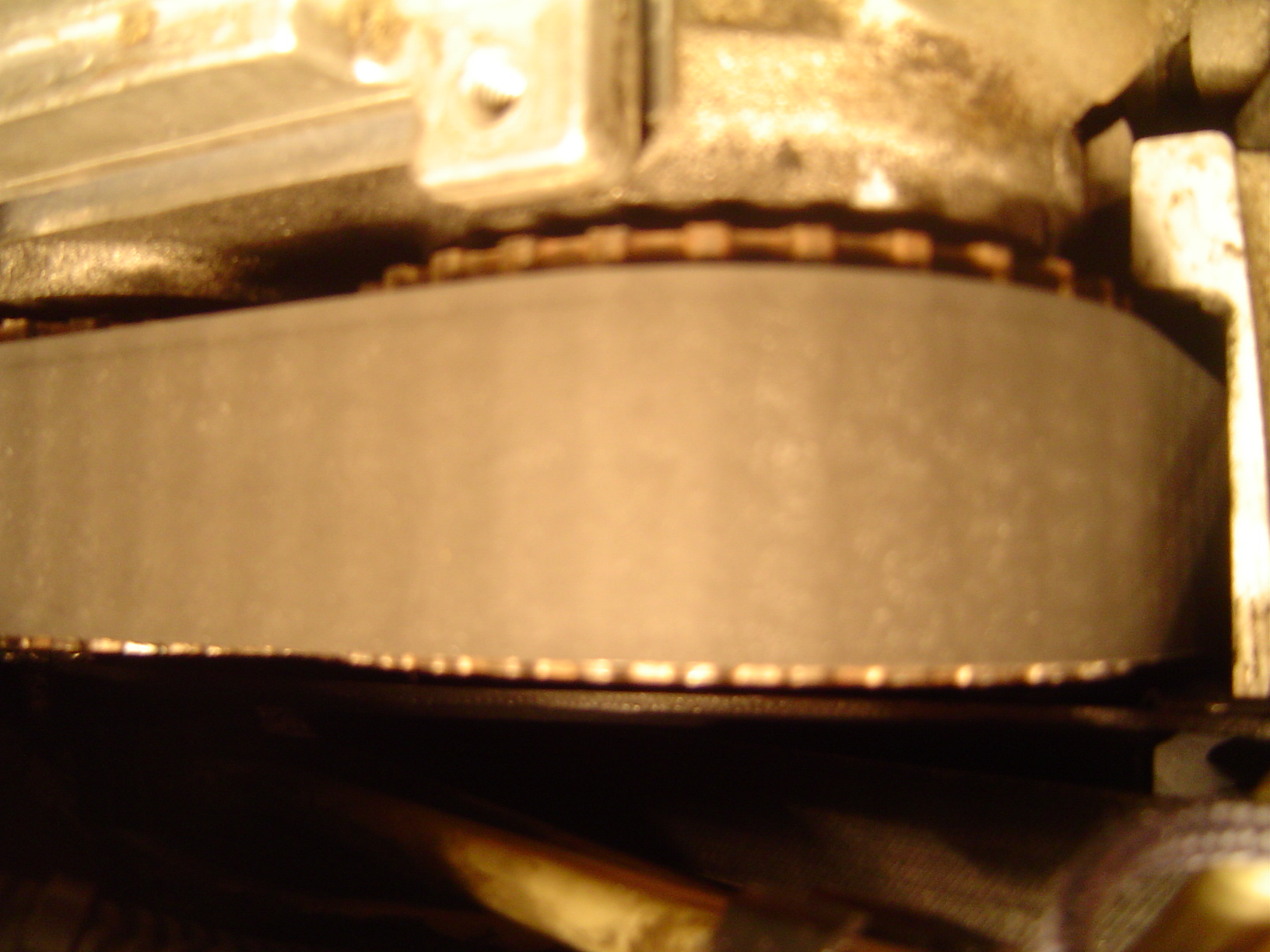

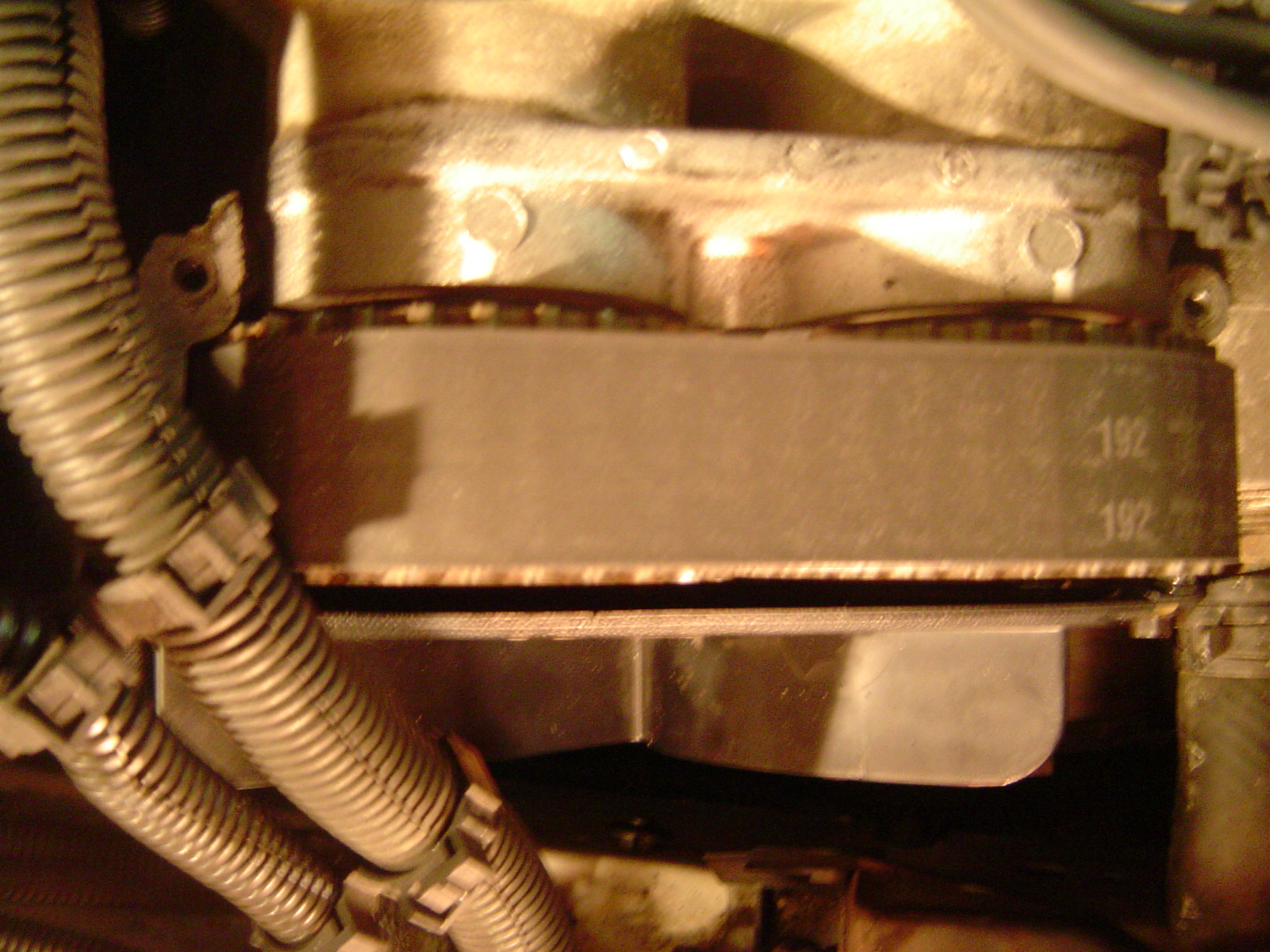

                  • #24
                    Here are some pics.....I notice that sometimes the rear cam has the belt all the way to the left....to listen to the car, pls download the *.dwg file and change the extention to wav.

                        Those belt pics don't look like they are too bad. My belt is not totally centered. Is the belt comming off, or hanging over?
