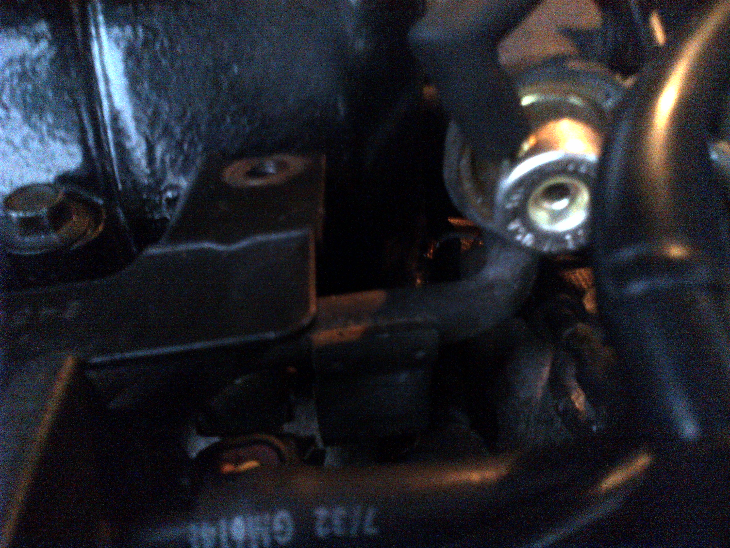

      I can see the FPR no problem, I've replaced it already. Just wondering if I need to remove it to adjust the pressure?

          I'm not sure where this screw is. I thought you might have meant on the front of the FPR, but there's no screw.

          • #35
            there isn't a torx head inside the hole in the center of the cap?
            • #36
              If the torx screw is missing this could very well be why the fuel pressure is so high. If I recall correctly you back out the screw to up the pressure, so with the screw missing it might be at its maximum.

                Ya, no torx screw, and neither did the one I replaced. If you have an extra I could really use it.
