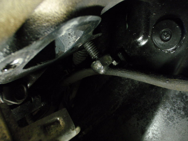

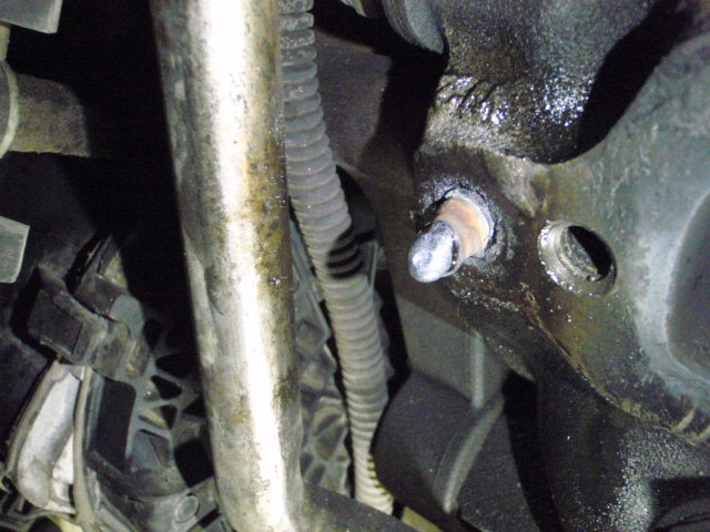

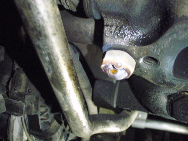

                          I need swift kick in the ass. ...Today... I just decided I could churn through a list of repairs that included silencing the constant "Johnny Carson Show Drum Roll" inside my busted OEM CAT on my '93 Z-28. I got a decent, direct fit replacement OEM quality CAT/Y-Pipe and after jacking the car and eye-balling and dowsing the unholy trio of studs/nuts (?) with soime WD-40, I threw a 14mm hardened steel deep socket on a half-inch drive with some long extensions on the outer one...and using my considerable (and thoughtless) use of arm strength, I snapped that effing bolt off like it was made of butter... flush with the inside of the thin, stock Y-Pipe flange! Now I'm usually the one who advocates proper planning and prep on most of the jobs that I do... but "Haste is the The Hand-Maiden of FUBARs" and I broke my own rule today and will probably suffer mightily for it. I read this post and some others on different forums...but I could not find anything suggesting how I work on this job laying on my back without having red hot welding spatter stuff and drilling spall dropping in my face while trying to rescue things. I am prepared to remove the exhaust manifolds and have a few replacements, gaskets, new hardened exhaust manifold bolts and some crossover pipe take-off flange stud kits coming just in case I wind up stymied with this busted stud while the exhaust manifold is in the car. I discovered an alternative to PBR Blaster on the gunsmith sites... it is called AEROKROIL (or Just plain KROIL in the non-spray jug) and supposedly...it makes WD-40 look like Super-Glue in comparison to its ability to bust rust and free things up. I ordered a few spray cans off eBay and will start with using it on the remaining untouched studs/bolts. Here are the links to some interesting related sites and some images of what one guy did by welding a nut onto the tips of not one...but three busted studs in one of his engine heads and then coaxed them out of the block. So Gentleman... any additional ideas from you all will be very much appreciated :

                          Oh... and props to RednBlack for the welding tip ...on the tip of the busted bolt... it's a pretty cool if it can be pulled off here in such close quarters...(See FTC Avatar in his Honor)
