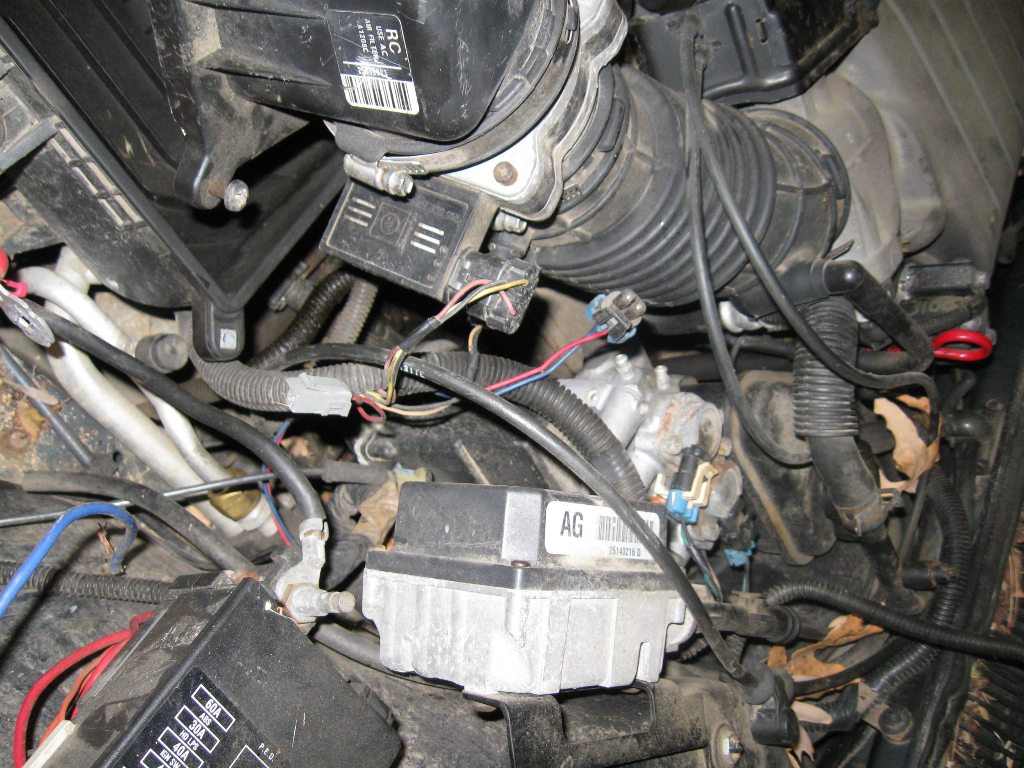

anyone know what these wires are?
  • Question : anyone know what these wires are?
    these are unplugged/disconnected-any ideas what these go to ?
    the one wire connector: i've NEVER seen it plugged into anything, so i don't know what, if anything it goes to.
    the second one, i'm not sure, can you get a better pic of it?
    comparing to the ones on eficonnection.com might be able to help as well.
    and what exactly is this? i see the file named GTP 07, and i see a MAF as well, so i'm going to assume 94-95 GTP?
      its the 94 gtp automatic with the stock 3.4 dohc engine in it-sorry about that.
        i took a quick look through alldata and the only thing i found with red and blue wires, that would be around there, is the washer fluid connector...
        i don't remember what the engine bay of GTPs looked like in 94, so that may not be it.
          That wire is def. for a windshield wiper fluid pump. It shouldn't go anywhere else. Plugs in by the battery.
            cool, thats what i thought, i know(think) the washer bottle got moved around a few times before the GPs body changed in 97...
              That blue wire looks like a aftermarket wire.
              Edit: Take a pic of where the battery is.
                ??? it looks fine from the pic...
                well, no_doz whenever you decide to post again, you should have all of your answers...
                EDIT: OK, now i see what you mean by blue wire... why is it going through the wheel well? i'm guessing its for a saound system, but it would have been a better idea to use the grommet next to the brake booster.

                        The single red wire with the gray connector is your fuel pump test lead. Touch it on your jump start terminal and you should hear your fuel pump start running.
                          THAT'S what that is? .......wow, who'd a guessed?
                            Si senor. I wondered after I got my car and did intake gaskets, thought I left something unhooked so I started asking people and found that out.
