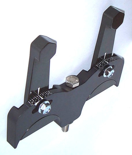

          unfortunately, i do not have any pix of the finished product b/c it was never made. the original tool is at the guy's shop where it has been since the 1st attempt but i will try to get in touch with some1 else i know and see if he will shoot me a pic of his original timing tool. the new tools will very closely resemble the originals except they will be constructed of stronger metal so they will still be useful after a few applications.
          i am not knocking the originals at all, great design btw.

              Will this tool work on the Front and Rear Cam Carriers while on the vehicle?
              Are all the Timming marks being lazer etched?
              And
              How does this mount? Is it a Cam hold down tool as well basicly?

                they work on both front and rear carriers, it mounts by bolting into the factory hole used by the stock cam hold down tool. yes it is basically a cam hold down tool but you can adjust each cam seperately unlike the factory tool.
                laser etched timing marks, unfortunately not. they will probably have the 0 marks on them and that may be the best i can do for the price. the original tools used stickers on them, i do not know how accurate they were and will not copy them. a degree wheel would be best for accurate timing and as long as there is a 0 mark for reference it should be no problem.

                      btw, here is a pic of the original:

                          So the tool adjusts the timing on the flats?
                          That way you don't touch your timing gears. Sounds great and easy!!!!!

                                u got it hayes, also i didn't know this until recently but the tops will be cut so you can use a wrench for extra torque to turn the flats.
