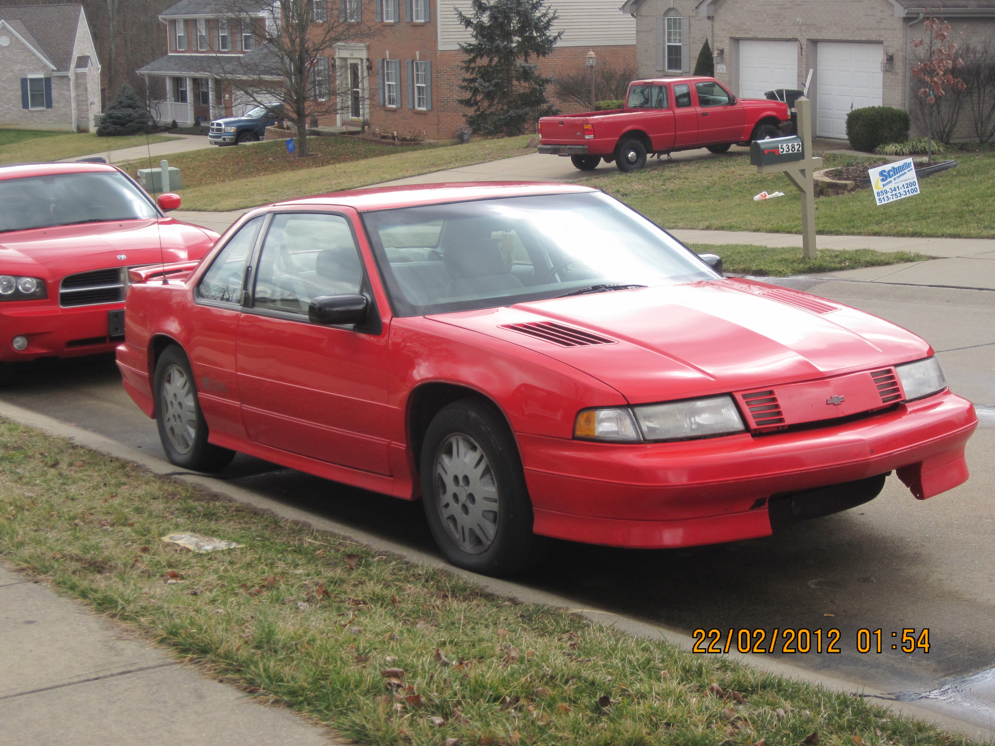

ID:	377203Nope,I threw it out before I thought about taking pic,sorry...but it was cracked right down the middle with melted plastic comming out of it..
                  BTW,here are some pix of the car
