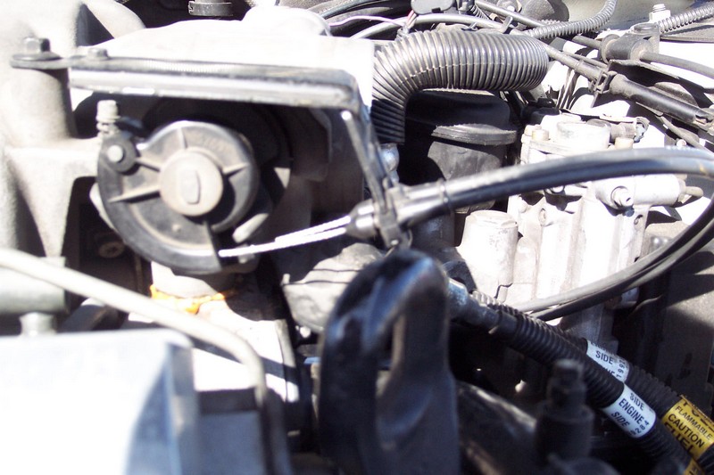

    the throttle cable appears free . anyone seen this before?

        Replace the IACV and clean the throttle. Then do an idle relearn.
