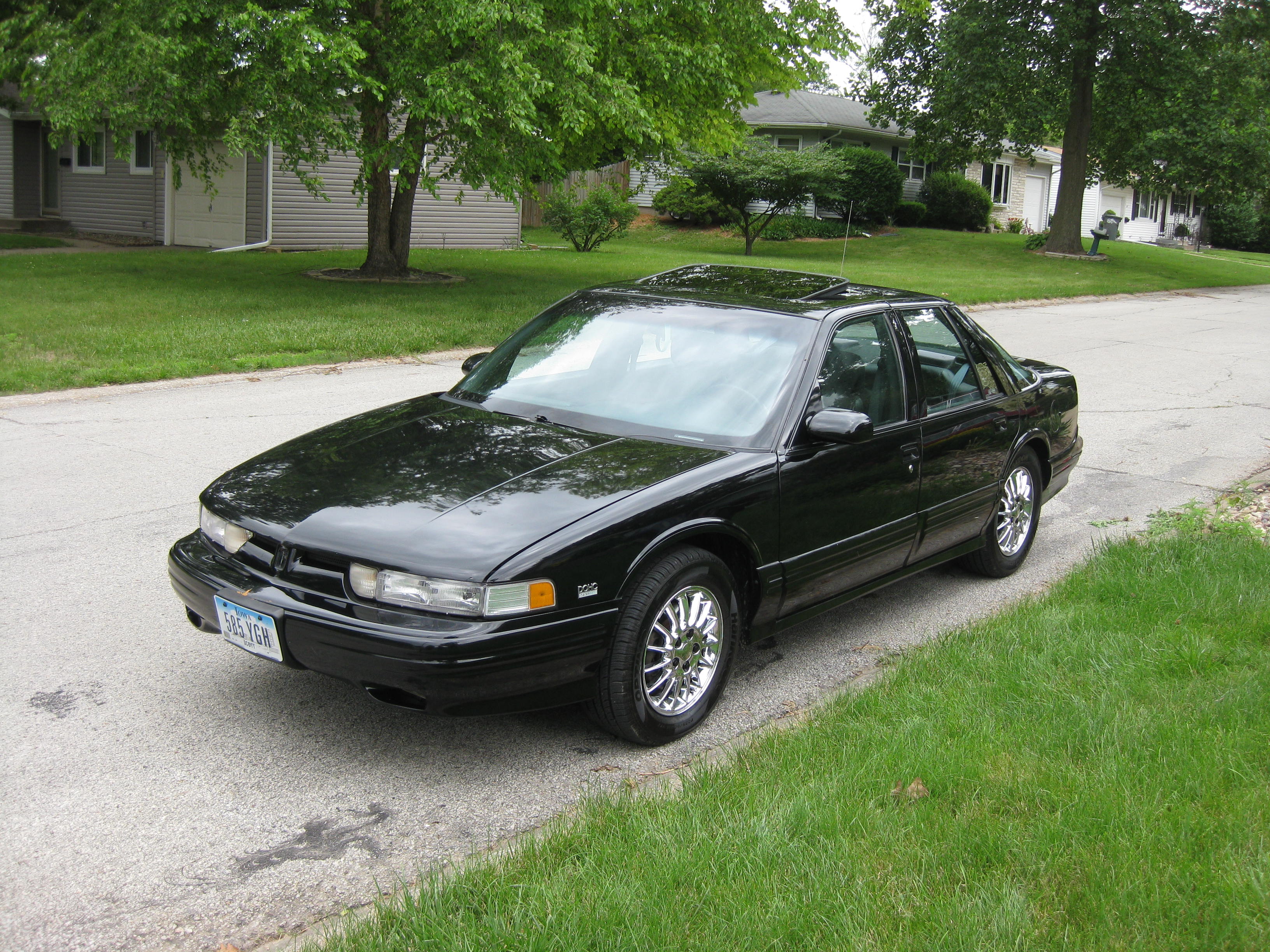

95 cutlass HUD. Project
[QUOTE=3100 MPFI;329061]You can put the HUD into anything you want as long as you have the patience to get it in there and looking good. As far as wiring goes, the cars are all pretty much the same in the wiring aspect.
I put a 2000 Grand Prix HUD in my 1995 Cutlass Supreme, and it works great. The Cutlass Supreme was not designed to have a HUD, so it had to bre custom installed.
This last one is the 2000 HUD in my 1995 Cutlass Supreme. In the first pic, you can see that the HUD UNIT is mounted UNDER THE DASH, and the dimmer is integrated into the headlight switch. The image is also smaller than the other two. The RADIO DISPLAY is not compatible with the OLDSMOBILE BOSE radio that I have in my 1995 Cutlass Supreme.
