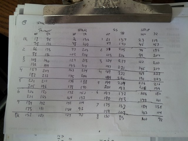

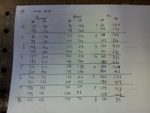

    The Thumper cam is based on the Comp Cams THUMPR lobes, and dynomation was used to compare how this works for the cams Comp made for the other motors. 2 cams have been ordered, one for a customer and one for our test car. Customer is OBD1 and we will be tuning it long distance. Test car has a few dyno pulls to do for results before we get to putting the cam in.
    I wrote some numbers down for the stock 3400 using the stock cam, street/strip, and the little thumper. This should give you an idea of how its gonna react. Of course with more mods the thumper is gonna make even more top end power. I want to get some real world results though.

      Added the strip cam on a stock 3400 as well. You could call it a strip cam with lope.
      Calculated VE at 1000 RPM is 64% stock. This cam is 49%. The cam I was looking at for the Big Thumper was 25%....
