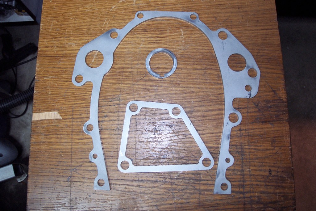

Us gen3 guys can't really fit a double roller timing chain because of the spacing and cam snout.. In the past people have stacked up paper gaskets on the gen2 engines to make this possible but maybe this is an easier way?
"Waterjet Cut Timing Cover Spacer For Double Roller Timing Set. "
Now, if it's possible to modify a gen2/1 double roller set to work with the gen3 cam snout i'd be very interrested. Or maybe if there is another GM engine that uses a single bolt cam snout...
Comments?
