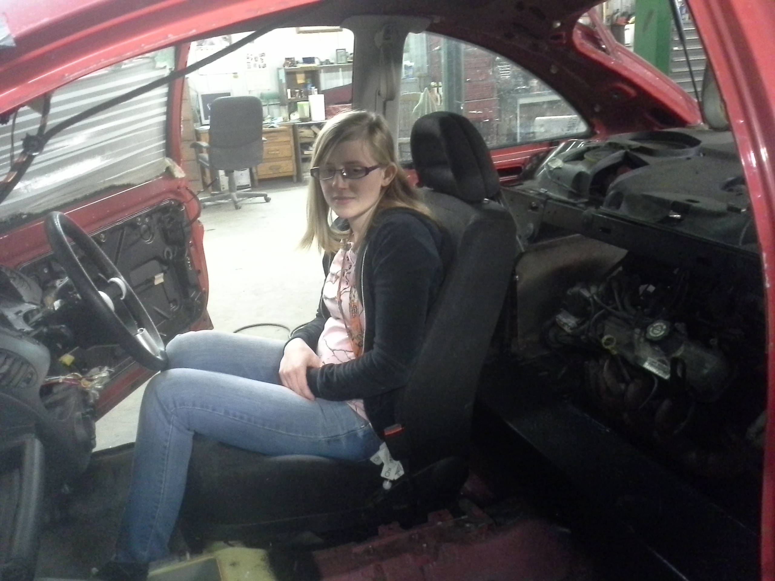

          • #20
            It's starting to look like a car again
            • #21
              She seems thrilled lol
