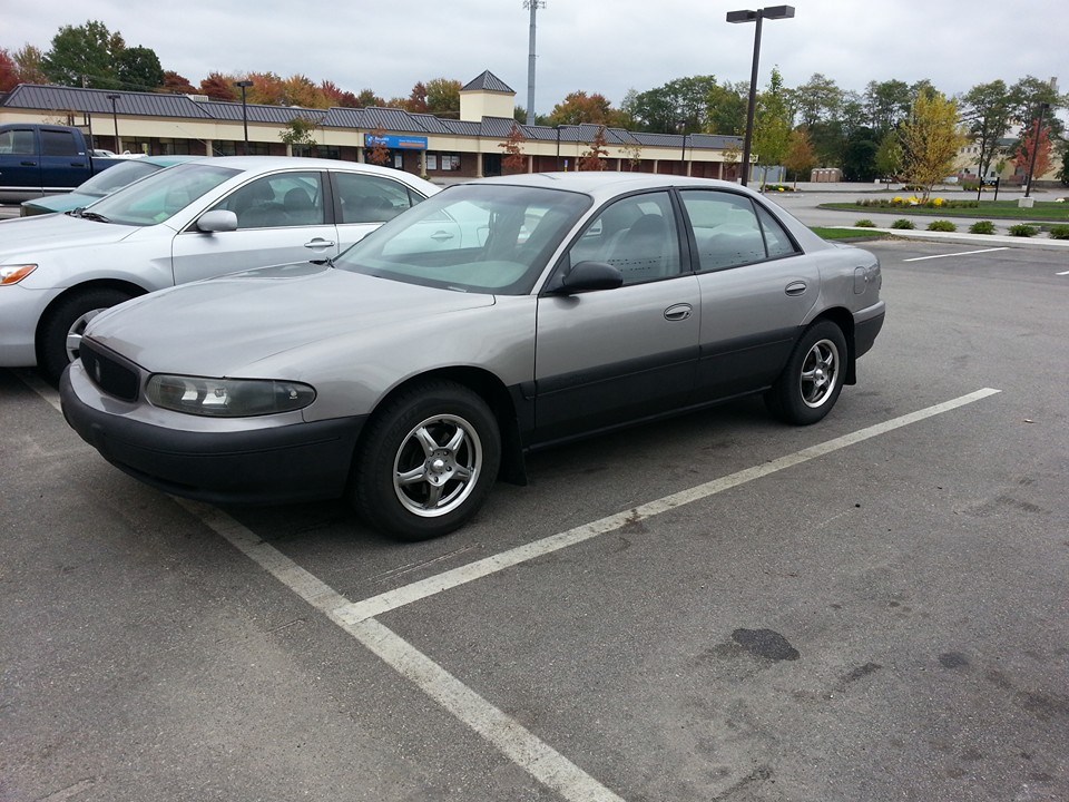

    I have a 99 Buick Century that I'm getting ready to do a LIM gasket repair on. While I'm in there, I was just going to do the head gasket too just for kicks, and do a port/polish and valve job
