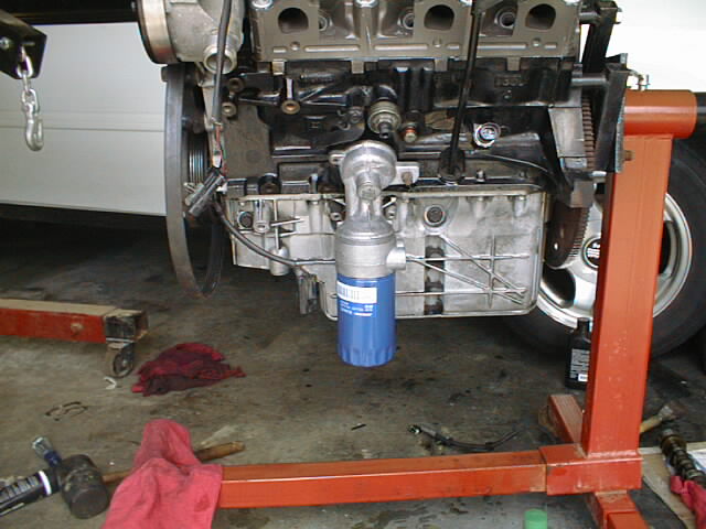

            • Brad, strange, with the angled adapter a PF52 is protected just fine on my car... It sits above the subframe...
              Lorenzo, the 3500 will not accept the 3100/3400 style oil filter adapters... But maybe they have something like you mentioned for the van 3500s. I was not aware that another adapter is put on to put the filter right on the block. I plan to swap my 3100 adapter over to the 3400 engine on my stand which has the filter right on the block. Good to know.
              • Here is a pic of the adapter, the oil cooler adapter and a PF52. Its hard to tell from the angle, but it sat just below the oil pan.
                • Ah I missed that you had an oil cooler on there. Never seen one before. Yeah I could see that would be too low with the oil cooler on there. With just the standard adapter it's about right, anymore and yeah that would be too low.
                  • I would not consider any downward adaptor for the w body, just no room in that direction...The regular GEN3s have a fitting screwed into the block. I am thinking that if you swap the cooler/adaptor with this fitting, then you can run just the oil filter. I would definatley use a minivan spec 3500 as a model since thier frames and exhaust routing is similar.
                    Lorenzo
                    • Hmm... I thought the downward facing oil filter adapter would be OK in a W car. I'm trying to visualize it now and the more I think of it the downward adapter would put the oil filter into the subframe but I'm just not sure. I'll have to check PCGuys thread again to see what he did there.
