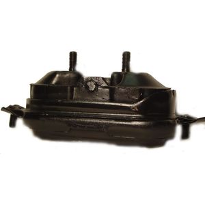

                        I checked the autozone site to see what the pushrod mount looks like:
                        The LX9 has a plate bolted to it that runs beneath the crank pulley... would this be the correct location for this mount to bolt up? I don't recall seeing a place for this mount to bolt up to on my subframe... is it there and I never noticed it?
                        it is only ~$40 but I don't know if I trust a motor mount from Autozone.

                          is it a hydraulic or solid mount? their solids aren't bad but the hydraulics are kind of iffy...
                            That mount sits in the "bucket" by the crank pulley that is in the subframe now. It looks a lot like the ones on the 3x00 minivans, except they have 3 places to mount to the engine. One front, one side (same axis as the crank) and one in the back.

                              Yeah Jon you are right. But the 3 piont mounting is due to the plate that is attached to te top of that mount of which you can get from the stealer or a junked car. All GEN 3 w bodies 1st and 2nd generation will have this. As mentioned, I also recommend the solid rubber mount as well, you can get that from NAPAonline.com. If you use pushrod main lower mount and the TDC rear mount and the pushrod torque strut, you will have VERY little movement in the driveline. Most of the wheel hop will be eliminated.

                                I'm not sure if the AZ one is solid or hydraulic. I will price hunt for a solid mount.
                                The LX9 already has the mounting plate so I should be good there:
                                Yes, I do plan on using the dohc rear mount and pushrod main mount. Still gotta pick up the dogbones/brackets - hoping to come across them for cheap on eBay.
