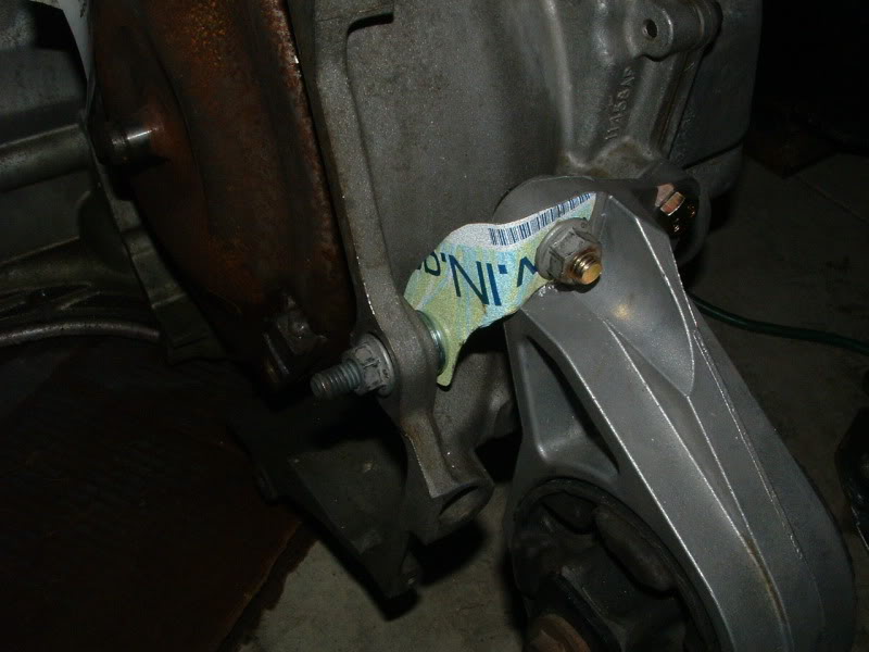

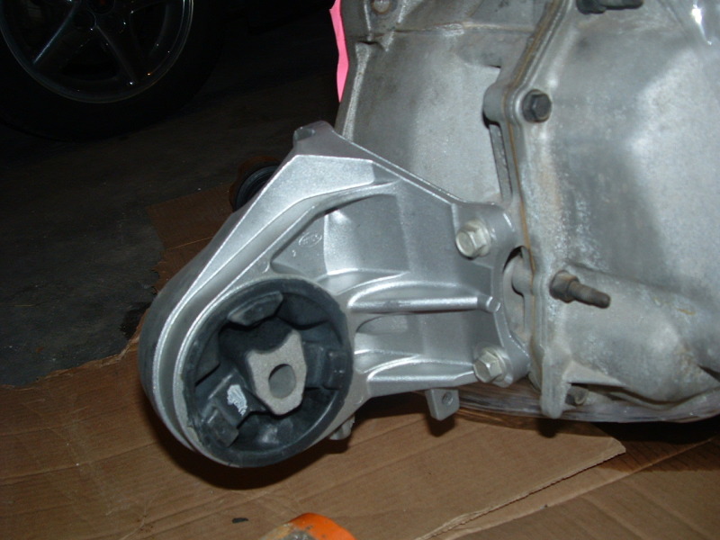

    This is the front mount off a 2008 3.9L G6. GM Part # 15299171 List Price $49.01
    The 3.9L G6 4T65E transmission has a special mounting boss on the case, therefore you will need to make a bracket to support the third bolt hole on the bell housing side of the mount. Note: The bracket in the pictured was for mock-up purposes. The actual bracket is made from thicker material.

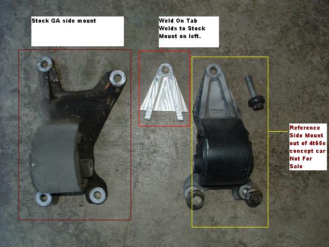

    Side Mount:

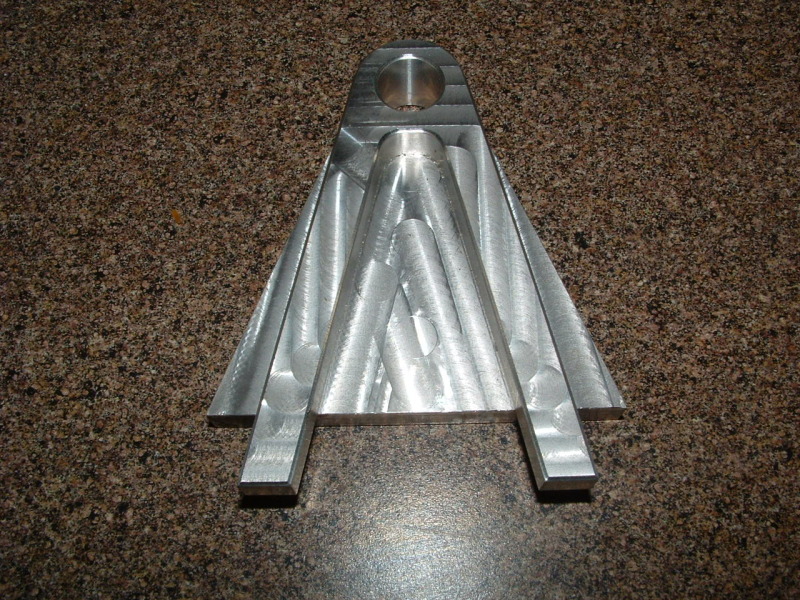

    In keeping with the design of the concept car, I had a machinist CNC machine an aluminum tab that can be welded onto the stock production mount. Note: if there is any interest, I can have more of these weld on tabs made for a cost of $45.

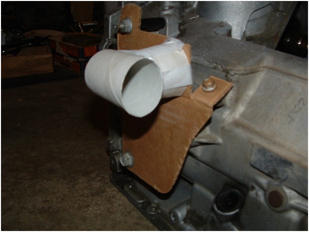

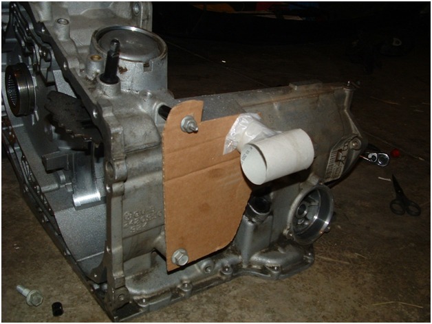

    Still in the design process, however cardboard templates should provide a good design template that can be copied onto steel. The goal is to create a rear mount that will work on both the 4T65E & 4T65E HD models.
