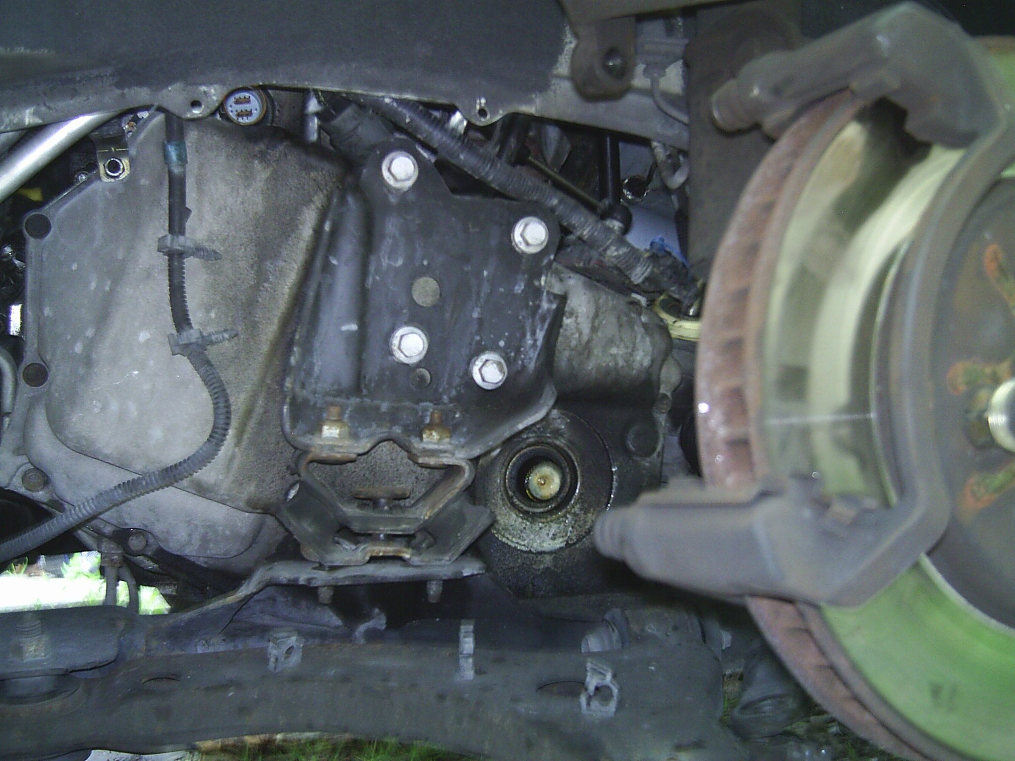

    Loosen torque on lower transmission bracket to engine mount nuts. (2)

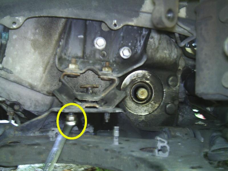

    Begin the process of lowering engine, transmission & subframe enough so transmission cover can be removed from the wheel opening. (A scissor jack can help control lowering of the subframe.) Lower engine support J-bolts, lower subframe until bolts are starting to take the load, loosen J-bolts more, etc.
    Keep checking clearance of hoses, A/C plumbing, wiring, accessories, etc. during the lowering process. Ensure exhaust tube is not binding or supporting the engine.

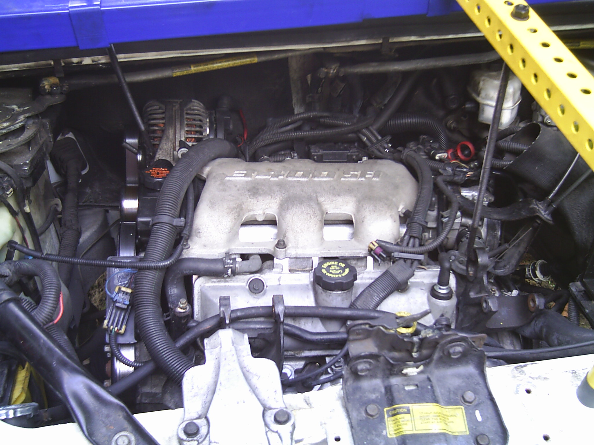

    Once transmission is low enough draw up all slack with the J-bolts in the engine support beam. Lower the subframe more so that you can access the lowest 4 bolts in the transmisison. You may need to carefully back out the passenger side subframe bolts a few turns. Confirm that the subframe isn't being supported by the driver's side strut, etc.
