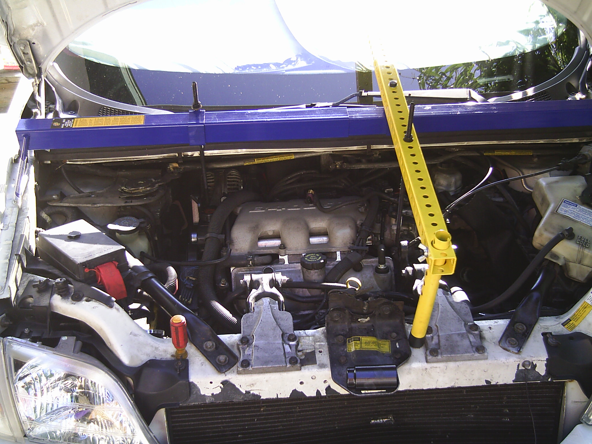

    Remove the thru bolts from the upper engine mount strut links and then remove the bracket from the radiator support on the driver's side. This will allow room for the foot of the engine support beam.
