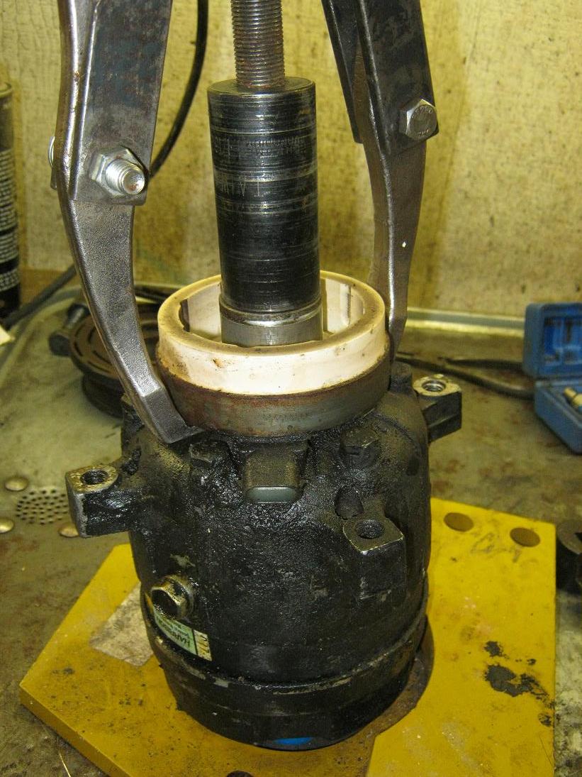

    Now use the puller on the clutch magnet.

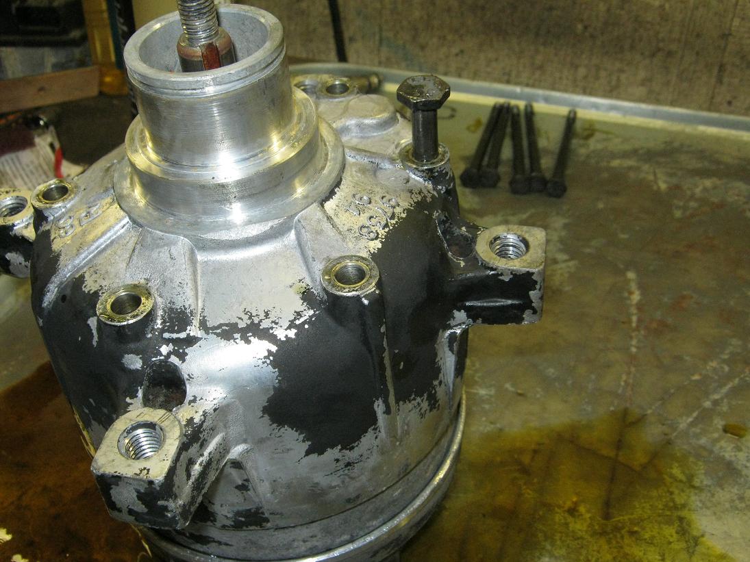

    OFF with the clutch magnet!

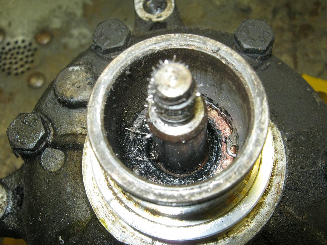

    Nasty looking. Will need to clean this SPOTLESSLY clean before opening it.

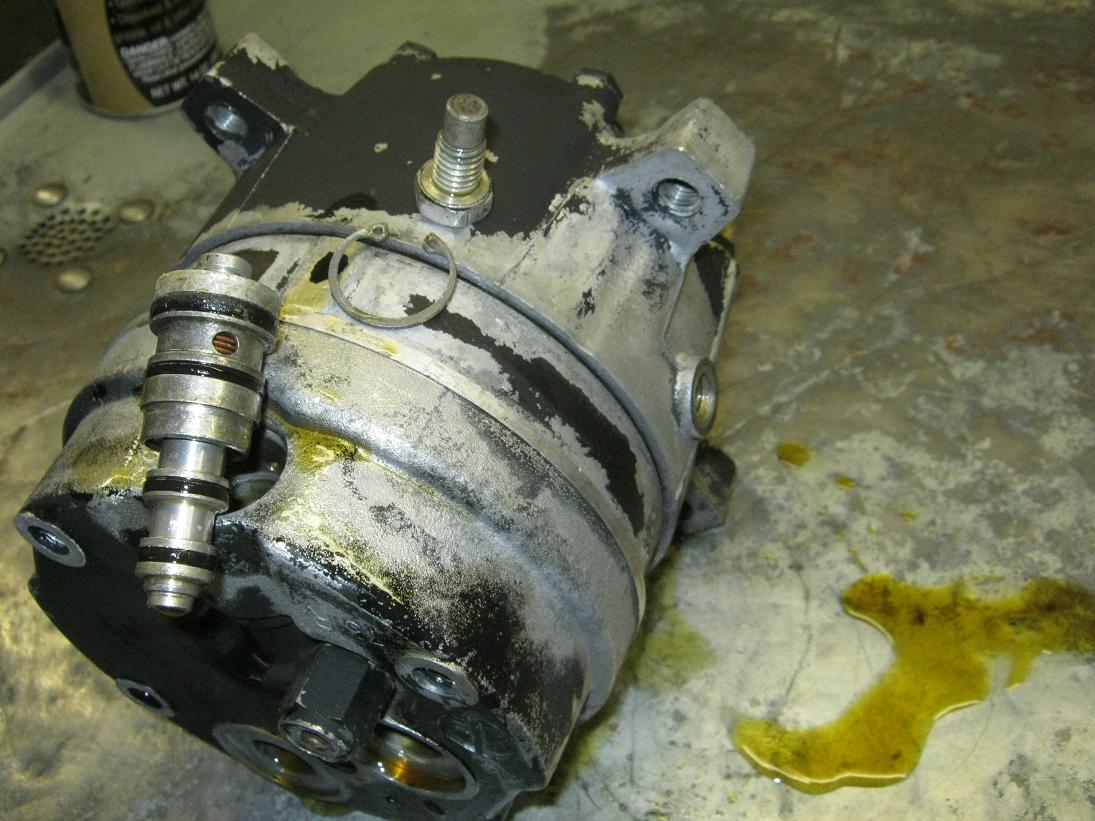

    After a few minutes with the Purple Soap and pressure washer, it's all clean!

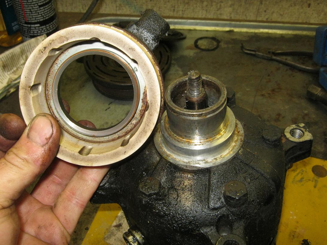

    Remove the external parts. Take out the compensating valve and the oil plug.

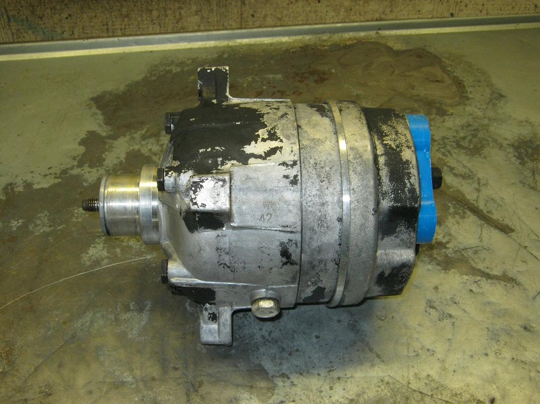

    Remove the bolts that hold the compressor together.
